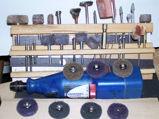

i have resorted to cutting long strips of 3m sanding film 6" long 1/4" or less wide (film because its tougher) then use it by guiding the strip with one hand while pulling it slowly then adding slight pressure with a finger on the other hand, it takes some coordination to drive the film and get the desired results i want, but grand paw would flip in his grave to know i was using sand paper, he was a purest and used blades only...
another thing i use "pic above" when feeling really lazy is to use the dremel with split mandrels with a piece of sanding film that i make multiple slices through on the loose end flap.. slow speed works best with these single flap mandrel's and the size if less than 1/4" works to get into most places where a knife is hard to get into...
one more thing is the dremel mnf makes some round slightly abrasive buffs
http://www.dremel.com/en-us/attachme...188569&G=66429
i use to some extent, they dont last long but really smooth out the fuzzes and snatch out tags if chips that would make through the paint job...
