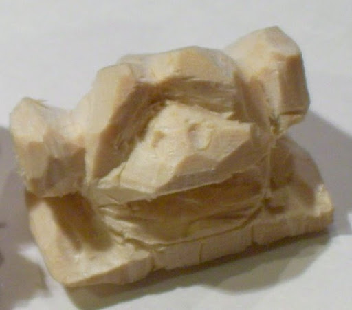

Well its finely done..
Using rick ferry's make your favorite carving knife Tutorial..
Keeping the blade cool at all times, Using a dremel with a fiber disk , 1x30 and 1x42" belt sander with different grit belts, I took a sheffield straight razor cut it down and attached a curly maple handle, its not my first Cutting grinding and shaping a carving knife,
but it is the first real carving knife iv'e made thats worth really telling about..
I found only a couple questions to ask rick, but they were not anything critical. and found the tutorial quite easy to follow, i put a lot of extra patients and work into this knife because i wanted rick to handle it and evaluate it.
Resulting in, I overworked the blade polishing with my power hone, Which rounded over the cutting edge,
then i burnt out a switch in my 1x30 belt sander, and finishing the knife would be delayed until i got a part from tiawan or wherever it could be found.
so i sent the knife to rick-in-seattle at www.littleshavers.com to have him do some sharpening touch ups, and evaluate it.
it was ground flat on the each side of the blade removing the round over at the cutting edge, flattened on the handle and sanded all over where i had had a real brier rabbit - tar baby fight with some 3 minuet epoxy, and I was
Thinking i probobaly had a failure with the blade cutting edge, being offset the centerline, rick was able to fix it. by sanding off some extra wood and smooth sanded and then coated with 3-5 coats of deft, resulting in a very fine knife,
i sent it out on Thursday and relieved it on following wed.
  • my advice:
  • keep the blade cold at all times, grind & dip in cold water.
  • don't use fast epoxy 5 - 8 minuet epoxy is best, fast working epoxy is fine but one little mishap could cause you to loose a lot if not all the effort you put into the work.
  • guard the positioning of the blade until the epoxy is set hard.
  • use gloss deft to finish the handle it really set off the depth and sparkle of this curly maple.
Again i thank rick for such a fine tutorial, and sharing his knowledge, know how and for being such a fine person to learn from.
heres some low rez pics of the knife attached. due to attachment restraints on wci, look on my picasa workbench album for bigger photos
