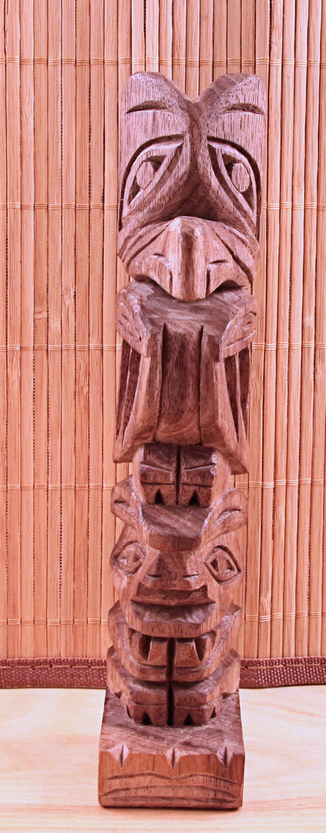

Well, you could always do like I did and carve a small one.

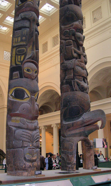

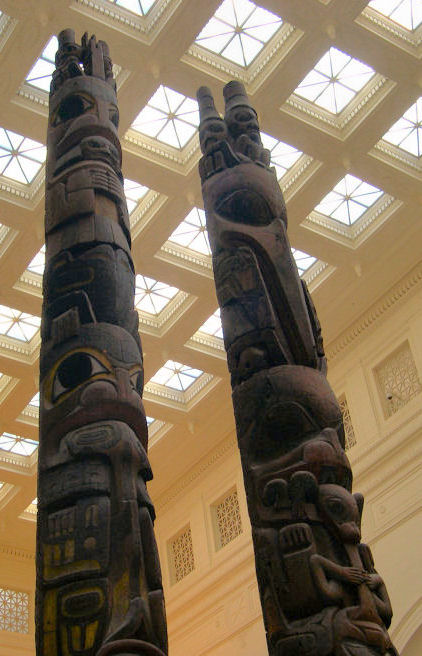

Here's a couple pics of the real deal at the Chicago Field Museum.

There are dozens of totem pole carvers in the Pacific Northwest. Charles Edenshaw's grandsons just finished and erected a new 40+ foot pole in Jasper National Park at the CN railway station
The poles in the Chicago Museum were taken from the Haida. The designs are regionally quite specific. Often the pole is meant to describe the clan affiliations of the home owner. Consider the CM pole shown on the right in the photo above.
On top are two men wearing potlach hats.
Below that is Raven, the Trickster, one of the most powerful totems.
Below that is Bear & cub, playing with someone's tongue
Below that but smaller is Frog, wealth and prosperity.
Below that is Eagle, not Thunderbird.
The entrance to the house was between the wings.
Haida houses were sheeted with WRC slabs (one was 36" wide) and might be 30' x 100' with a 12' ceiling. There may have been a slave buried alive under each of the corner posts of the house.

Nomad: I like what you did. Eagle on top and Bear underneath? Also pleased to see that you didn't paint it. Just my personal tastes but I don't think that small totems need paint.
