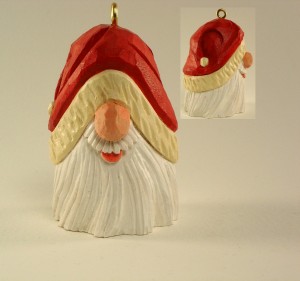

Pictures of woodworking and boat building projects on my blog are usually made in the workshop and show a well used workbench and other shop environs in the background. Those are suitable to the subjects.
However, these backgrounds make small woodcarvings look like they’re lost in the slums. Need better!

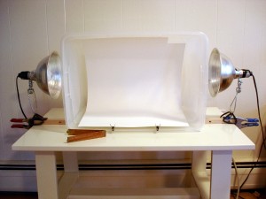

Following an ingrained do-it-yourself streak, I made my own. I had all of the components already on hand, some seeing only occassional use. So, this turned out to be a no cost lightbox. It can be easily duplicated for quite a low cost, depending on what you have around the house or shop.

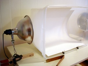

The box itself is a plastic storage box that is about 22 inches by 15 inches by 12 inches deep. Wallmart calls these “56 quart storage containers,” and sells them for about 6 dollars each. The clamp lamps are the 8 inch size and are available in home centers for 6-8 dollars apiece. I used a piece of watercolor paper for the background. It is simply curled within the box, not folded, and held in place by the two little black clips. A couple of squeeze clamps and some scrap lumber hold the clamp lamps in place. It’s all very simple. The plastic has enough milky tinting to eliminate the need for any cloth to diffuse the light. Regular (pre-ban 100w) incandescent bulbs provide more than enough light.

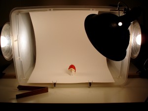

The box is easy to use. Set up the object within the box. Use a tripod for the camera, and be sure to set the camera’s white balance to display the colors you actually see. I sometimes use three lights, placing one in front to gain the balance of highlights and shadows that I want.
Now, I can produce pictures that let one pay attention to the woodcarving itself, and not the dings, dents, and stains of a well used workbench.

A great idea Bob. Very effective. Now, how did you get the little inset photo in the big one. That is very effective too.
Ed, that's the combination of two pictures. Resize one to be about 25% of the other and paste it over the top of the larger. You can do this with most simple graphics editors. The principle is the same in any editor, yet the step-by-step instructions may vary, do I won't even try to itemize them.
